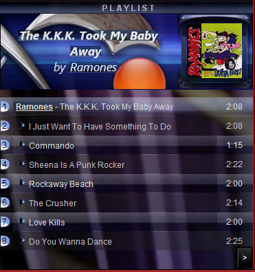

Author: Subject: a:visited {} not working in playlist.dis
puzzled.gif posted on 9-8-2008 at 12:08 PM Edit Post Reply With Quote

posted on 9-9-2008 at 10:34 AM Edit Post Reply With Quote
posted on 9-9-2008 at 11:49 AM Edit Post Reply With Quote
playlist.jpg - 77.03kb
posted on 9-9-2008 at 12:15 PM Edit Post Reply With Quote
